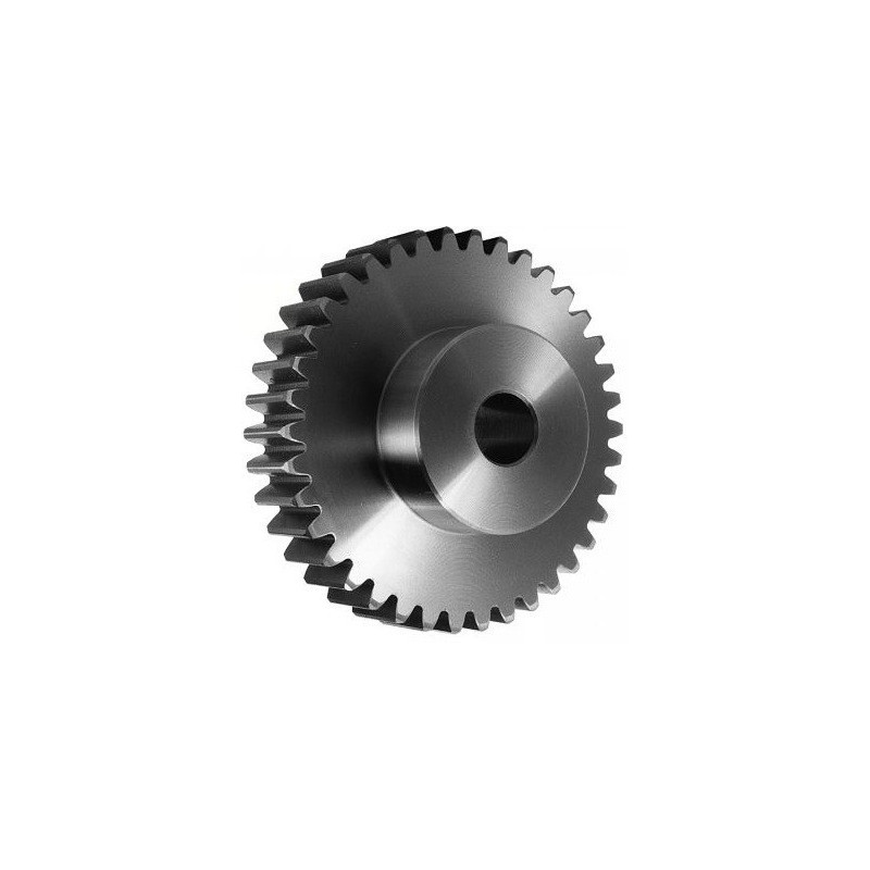

Unfortunately, when I bought my pf25 the only gears I found, were installed on the table. The gears are 53, and 40 teeth, it means that I have only the two lower speeds and I need more. Infect, a VFD is installed but it is not enough, the table is still too slow.
Searching the net for additional 4 gears, I came up empty. The price is too high.
The gears are 1.25 module, 20,73,29,64 teeth, and quite unique. You even can't find easily the row gears.
New thinking was required and I came up with this idea…. Changing the dimensions of missing gears to 1 module which are easy to find, instead of 1.25 module.
Calculations:
Sum of the original gear pair is 93 teeth multiply by1.25 = 116.25 mm. this is the DP of the 2 gears combined, and the distance between shafts is 116.25: 2 = 58.125, and can be related as 58 mm.
In Aliex. I'v ordered 2 gears 36 and 80 teeth 1 module, for first evaluation.
36 + 80 = 116 mm (combined DP) / 2 = 58 mm, and the ratio is 36/80 = 0.45.
The original gears ratio for the second speed is 29/64 = 0.45 ……… ..yaeeeeeeeee!
To be continued with more explaining and photos …… .. thanks.

Here ar some photos of the procces.
this is the first evaluation. the 80 gear still don't has the inserted hub.

The main issue here is pointing out the option to move from 1.25 module to 1 module gears as long as you keep the formula
Z1+Z2=116, and you can get any gear ratio and any table speed.
